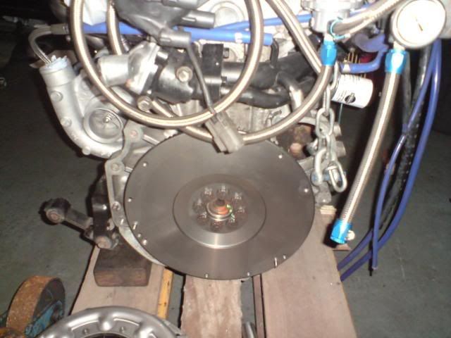

where does the pipe from the header tank go to?
and where do i connect teh bottom coolant pipe from turbo?
jjs
hi, the header tank goes to the radiator, filler neck just below the filler cap, and the pipe on the bottom of the turbo is the oil return to the engine via the connection on the engine block,
williams
not that 1 mate, the other pipe/hose, its a water pipe, its a steel braide hose with a brass fitting on the end, as though it goes into a rubber pipe. i have 3 pipes/hoses from the turbo connecte to the block alreay.
gtir_pimp
are you on about the coolant pipe at the front of the turbo? if so it goes to a rubber pipe on the right of the rocker cover as you look at the engine. the one at the back goes to the block
gtirjoey
What he said
the coolant pipe coming of the expansion tank goes to the rad just by the filler neck
williams
i'll have to have a look. anyone got a pic? didnt realise there was a coolant pipe on the rocker cover?
