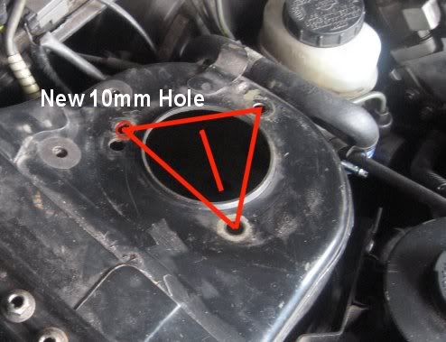

Sunny-D
The line within the triangle is the normal camber adjustment, so on that side of the car the topmount was turned clockwise to the next hole. The circled corner is where the new hole is drilled.
I had to drill a new hole in my strut brace aswell, i will have a look for another pic.

ok so if i take the the nuts off drop the coilovers drill a 10mm hole approx i nut away from the existing hole, then rotate both coilovers clockwise and refit nuts thats it?
apart from doing the same to the strut brace obviously, that seems simple enough.
what camber did you achieve doing this?
i was going to modify the strut mounts anyway as i can only get -5deg at the mo, i want -1.5deg for zee track,will this solve both camber and caster
Sunny-D
The guy you need to speak to is Jim (campellju).
The drivers side needs to be turned clockwise and the passenger side anti-clockwise (looking from the front of the car).
I made a template for the topmount using the rear topmount gasket iirc, two holes will line up perfectly leaving the hole that needs to be drilled.
After this mod you may need to do the camber mod (elongating the top hole in the shock) to dial in a bit more camber.
