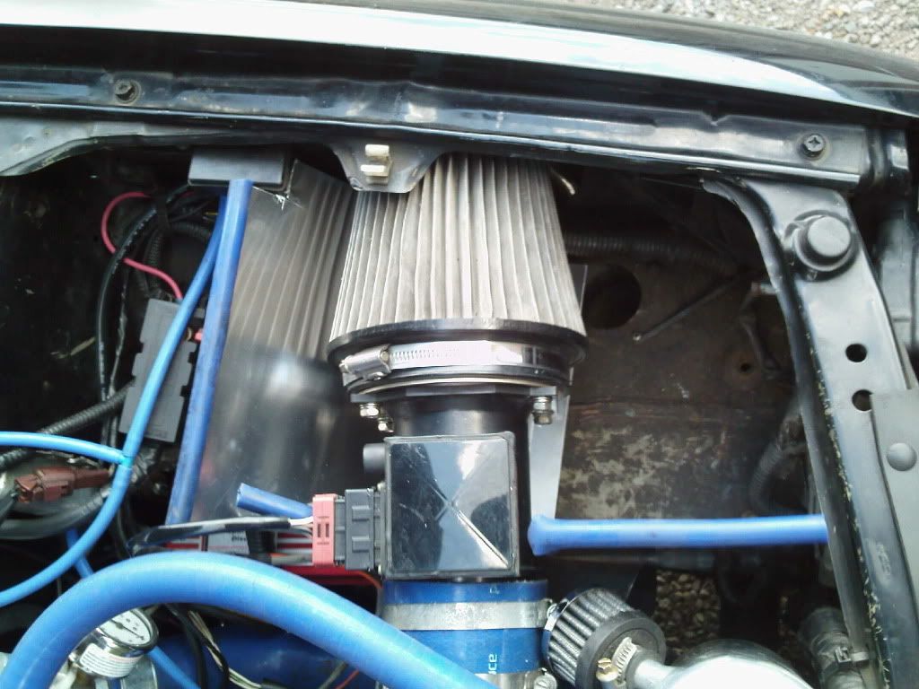

Took it the long drive down to Ed's at Fusion and after a bit of tinkering it was mapped on Surrey RR.As usual for me nothing went smoothly but at least it was no longer holding back at the topend like last time.Am 99% sure it was down to a poor air feed for the filter and the stepping down from 3" downpipe to 2.5" post cat exhaust system.That wasn't a problem this time as it had a full 3" exhaust and I'd tidied up the feed for the filter and got the problems with the actuator diaphragm on my gt3071 sorted.

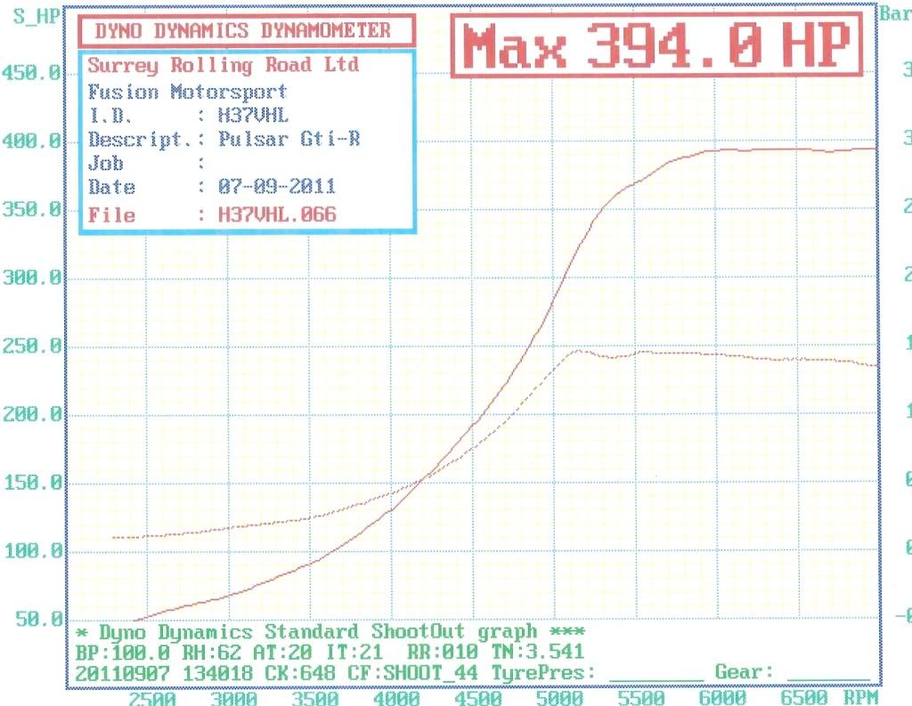

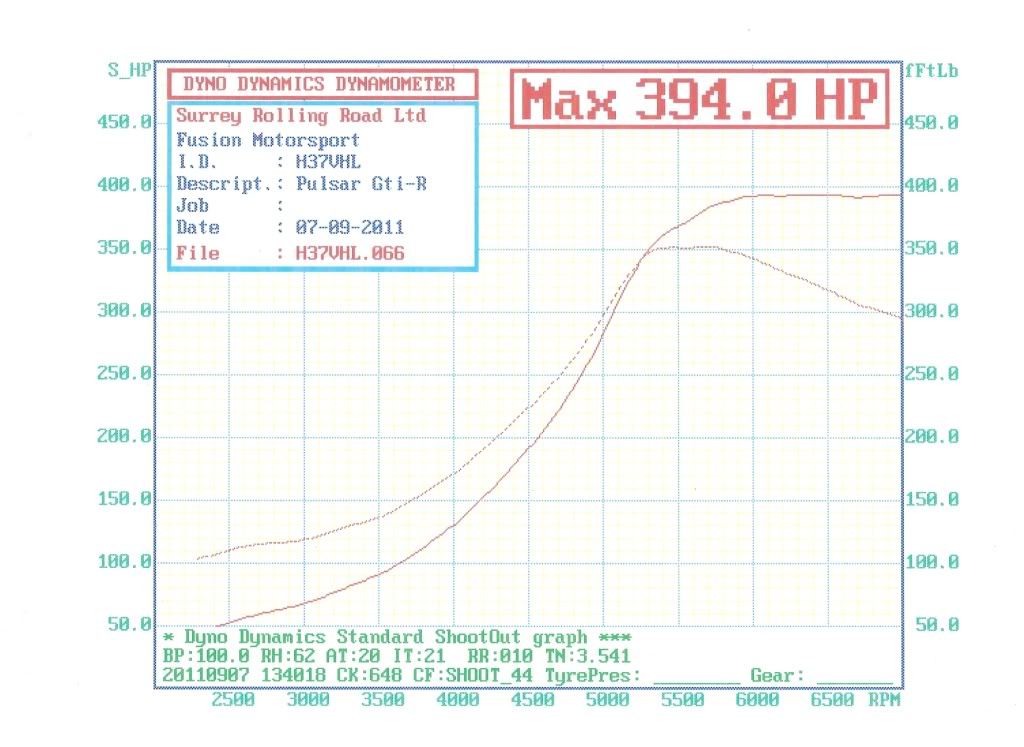

The car had a misfire after 1.4 bar, so was only able to be mapped at that.Bit disappointed as was hoping for somewhere around the 1.8bar mark and 450ish bhp, but what it achieved on the day was very good for such low boost.It made 394bhp/350lbft on 1.4bar.
The power is still very strong at the redline, so still a lot left in the tank if I have the energy to get it mapped a 3rd time
