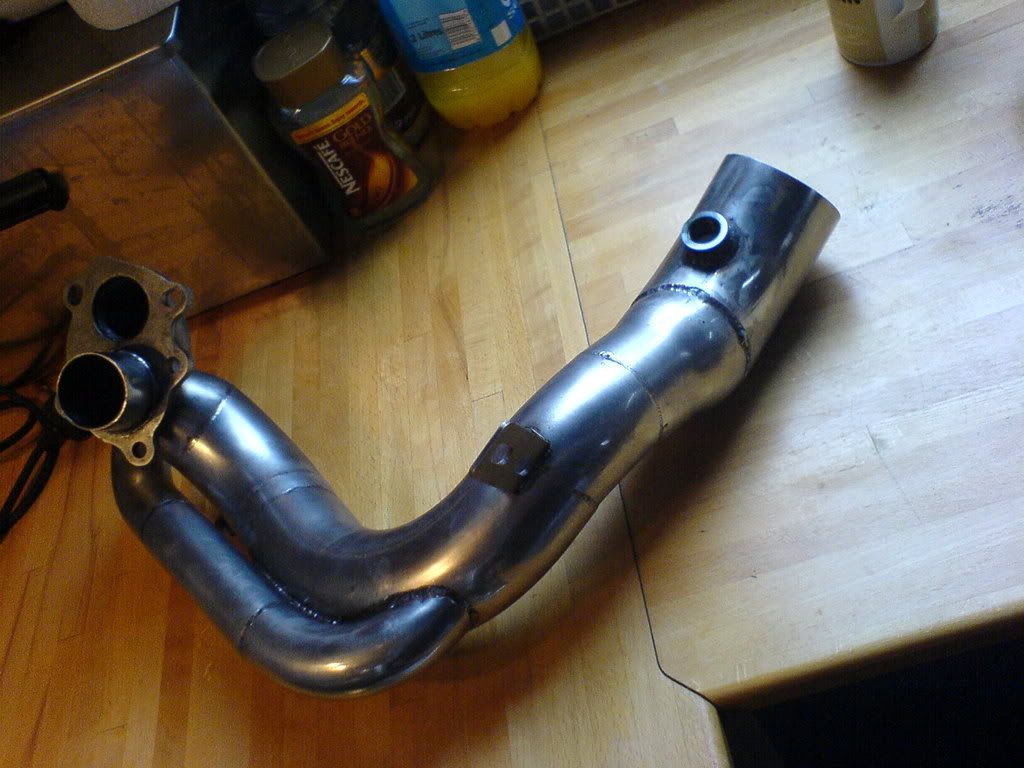

How did you get on with it ??Braveheart said:Yes, the boss is sitting to the side of the exhaust... that's as far away from the turbo as I could get it with that down pipe. There is no room there to fit it vertically. The boss has been fitted pointing 10deg downwards towards the bottom of the pipe so I do not exspect problems with sitting moisture. I'll let you know how it performs if and when I get the car running.
