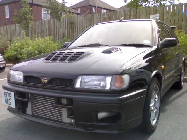

My standard boost gauge shows -7 to +7 as they all do but the needle never seems to move from the middle - is this normal or is it broke?
Also what is the standard boost and what can you get the boost up to and where do you get it done?
I fancy about 300 bhp for my car what bits will i need?
Sorry to ask lame questions but i know sod all about tuning cars and ya have to learn some how.
http://i67.photobucket.com/albums/h3...4052006025.jpg
