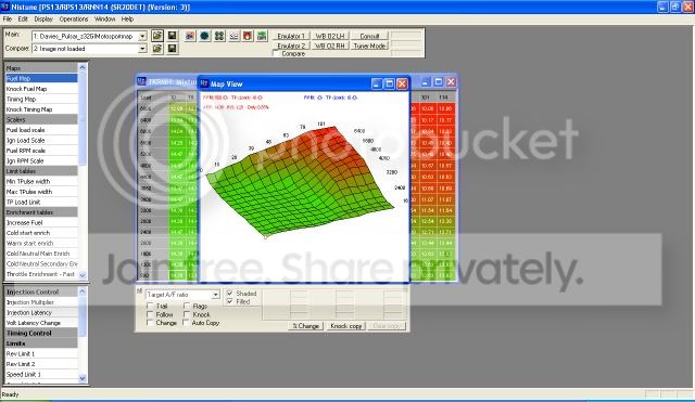

As for the mapping, that went well.
We decided to aim for a safe 350bhp at the flywheel.
The mainline dyno that Russ uses measures the power at the wheels and the fudge factor for the GTiR is a whopping 90bhp for flywheel power... :shock: So the figure we where looking for on the dyno at the wheels was 260bhp.
First run at 0.7bar (10psi) the car made 194bhp at the wheels (approx 280bhp@tfw) and the fueling looked pretty good so we left that and went for the target figure of 350 which was easily acheived.
At 1.1bar (16psi) after some small fueling tweeks the car made 258bhp@ the wheel = approx 350bhp @ the flywheel.
Injector duty cycle was 67% so the car has a bit more to give.. ;-)
